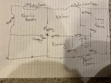

If you can post a sketch of the floorplan that includes stove and stair locations and room openings we can be more precise. Start another thread on the topic if considering other model stoves.
dvd1217
Feb 12, 2023
13
NYC
Not sure how clear this is.
begreen
Mooderator
Staff member
Nov 18, 2005
101,053
South Puget Sound, WA
That's perfect. In this case, a 12" table or box fan, running on low speed, on the floor at the family room opening, pointed toward the fireplace room would enhance circulation. It would be worth trying placement at the living room entrance to see it that further enhances heat distribution. In that case, I would lean toward the larger Regency i2450, Montlake 300, or Cascade insert. If not, then the smaller Lopi Evergreen or Montlake 230 would suffice.
