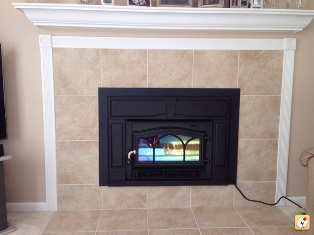

I have the same situation with my Jotul c350. I can only increase room temp about 2 degrees when it is at max temp.
I can feel radiant heat, but air temp isn't changed much. I wanted mine for only supplemental heat, but I thought it would throw way more heat. I can keep the thermostat set a couple degrees lower and burn the insert to make it comfortable.
I stuffed roxul around the liner. I can't put a block off plate without removing the stove because it is so tight. Also the liner was such a tight fit down the existing chimney I don't expect a lot if heat going up. This is all installed in a ZC fireplace.

You would be amazed at how much heat can go up along side that liner and be absorbed through the masonry and released the the great out doors. Insulation does not stop air flow as a block off plate does.
Great looking install, though. When it is ZC fireplace what kind of chimney do you have? And is there no warm air coming out with the blower?
Thanks. I am definitely really happy with how it looks which takes a little sting away.
My existing chimney is an 8" triple wall air air cooled pipe. An insulated 6" liner was installed.
Hot air does blow out, but the fans don't seem to move all that much air. Standing right in front of the stove it is nice and warm.
I agree that my setup might not be ideal. I think I would have to pull the liner up to be able to pull the stove out based on what I saw when it was installed. That has stopped me from pulling it out and trying to make a plate.
