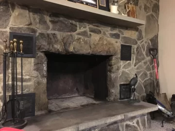

I cleaned the stone around the opening tonight. Messy job. But after just buying $530 in heating oil I'm ready for a change.
We are ordering the stove next week. $2700 seemed fair
