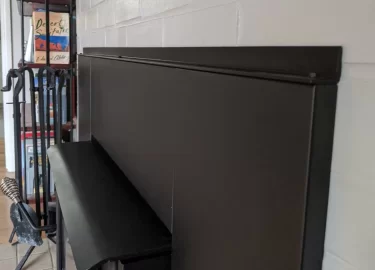

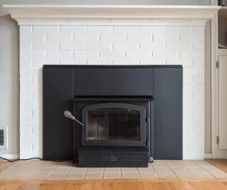

I ended up buying a piece of 1" steel angle from the hardware store, painting it black, and attaching it to the top of the insert faceplate panel. It covers that 3/4" of vertical space and looks pretty good I think. Check it out.

The angle iron actually looks like its suppose to be there, looks real good
Reactions: jimcrook
Simple fixes are often the best. Looks good.
