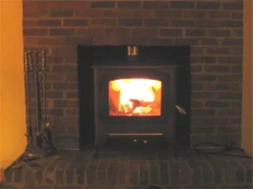

OP here. Brother Bart, love the pic and your "no opinion." :) We are considering an Englander as well.

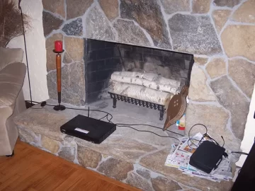

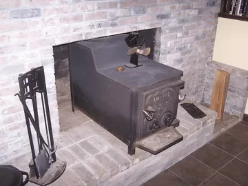

In our lower level, we have an old non-EPA beast that sits on the hearth and uses the existing chimney flue. This is what we'd like to be able to do upstairs as well. The first pic below is the lower level beast; the second pic is the FP upstairs where we are considering adding a stove.
[Hearth.com] Insert v. freestanding stove
After my husband cleans up his toys sitting on the hearth, ideally we could put a freestander on the hearth?
The measurements are:
Hearth depth: 21"
Opening top to bottom: 29 "
Opening width: 42"
Opening diagonal: 51"
Firebox depth: this gets tricky because it is slanted, as you can see in the pic. At the top of the firebox, depth is only 16"; at the bottom of the firebox, depth is 21".

Well it looks like you will need a hearth extension to do a free stander upstairs it is not an issue with the other one as long as that tile is over concrete. Also you will need a liner and you should have one on that old stove to using the existing flue is not safe or efficient. It is a real pain to clean and unless you have a liner atleast running up into the clay liners it is against code.
bholler - thanks. I should have been more clear -- the lower level air-tite uses the existing chimney, but it has a liner and is well cared for by the chimney sweep! Since we installed the tile, we know it is tile over concrete. As for the hearth extension, what does that entail?

Based on your dimensions that opening should fit several nice inserts including the Clydesdale, PE summit, and several others and with the 21 inch hearth you may not have to extend depending on the extension of the insert into the room. I know you can put the Clyde into that fireplace with just an insulated liner and a block-off plate.
