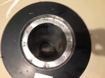

I just bought a house in PA. They house was built in 1988. The owners had stove pipe installed
But never installed a stove. They used jackes Evans pipe. Can anyone help me find a compatible stove pipe adapter?

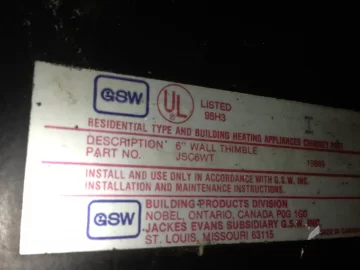

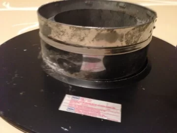

Yes, excatly what I mean. They installed a chimney thru the wall of the basement out of the house. But they never installed the stove. I am trying to install a stove into it but I need the proper chimney pipe adapter. Or something that will work with the Jackes Evans Chimney. Them seem to all look the same to me. Sorry for the confusion.
Any advice would be great.
Thanks

Some pictures hopefully it helps.
  • [Hearth.com] Install help
