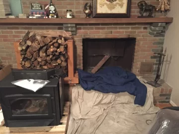

Current state so far. Two side cuts and bottom cut are done on the metal firebox. The top cut still needs to be done and there might be a second top cut with the way this one was built (the top of the metal firebox angles to the back wall at the top).

Wow they couldn't notch the box out in an afternoon? That really is an hour long job at most.

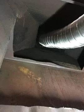

The cutting was finished and the liner is dropped in, lunch time now. The metal firebox was made in a way that it formed its own smoke shelf, no masonry or sand. Based on what they normally see around here, this was a bit unusual to them. You can see behind the iron they cut out is more steel.
yeah that is what i deal with a lot good cutting wheels go right through it.
Gotcha. Well either way, they got the job done. The top cuts were a lot easier it seems.

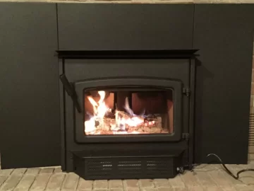

Here it is with the first fire (after I let a kindling fire go out). Had 6 splits to start loaded log cabin style to get a hot burn to get the paint cured. Added a few more splits afterwards to just enjoy. It stunk but not overpowering really, just let the bathroom fan run nearby. Basement went from 54 to 68 in no time. Eventually I'll load it up and start testing moving heat upstairs and how successful that will be. For now, I'm going to learn it first with smaller fires and focus on keeping the basement comfortable. So far seems very controllable even with a flue that's just shy of 27'.
There are some tweaks that I need to make, both with the surround. Need to put the hack saw to a vent cover that is in the way. I also need to adjust the surround as it doesn't want to sit right. That'll take some tinkering.

Your heatilator looks very close to the one I have. Just curious - were the installer's pros? I have the same structure, 1/4" steel firebox that slants up and in towards the living room, and 1/4" steel smoke shelf that angles up and toward the damper and room. I can see that if I cut the smoke shelf out, there will still be a 1/8" steel surround that angles up to the chimney (like yours).
a. My installer doesn't want to remove the entire smoke shelf, only wants to torch out an ~12 inch oval (for the six" insulted liner).
b. Since I want to add a layer of stone over the existing brick in the room, he doesn't think the back of the fireplace will have to be notched.
c. Did they install a block-off plate for the liner after you took that picture?
d. From the picture I couldn't tell, no insulation on the liner?
Does anyone see a problem with stoning over the old heatilator vents in this case (steel inner firebox, steel outer box, brick and masonry surrounding the steel outer box, exterior brick chimney/flue (with new 6" insert 1/2" inch insulated wrap) (i.e. this in not a modern zero clearance heatilator that is installed within framing)?

Go ahead and cover them up. No worries on this type of fireplace.
They were professionals and certified.
To answer your other questions:
a. Cut out only what you need to is my philosophy.
b. I would suggest understanding final dimensions if you're going to put a facade on. I'm going to do exactly what you're thinking, including covering up the vent openings...eventually.
c. I will be installing it.
d. I knew I'd get that question with that pic. It's there, just with the flash/lighting you can't see it.
