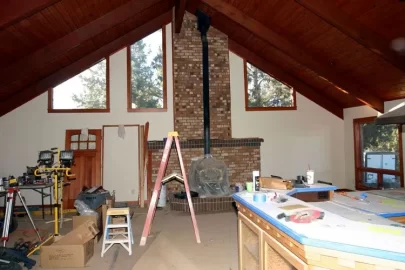

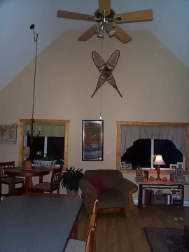

The stove will be installed in a "cabin-style" home which has a 2-story tall (18') kitchen and living room and a 2nd floor loft which overlooks the kitchen/living room. The stove will center on the outside 18' tall wall. I have attached a picture... the stove will go where the chair is currently.
I am not sure if I want to install the pipe straight up, or go up 6'-8' and out the side wall. My preference would be to go up and out because I am not crazy about seeing 14' of 6" pipe, but I don't want to sacrifice function. I am also concerned about sealing the penetration as my roof is corrugated sheet metal (12/12 pitch) and those rubber boots look like they would be hard to seal up compared to a wall penetration.

  • [Hearth.com] Installation questions (cathedral ceilings)

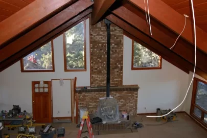

I'll get one today...house is in the final throes of a major remodel, but you'll be able to see the stove installation amidst all the industrial debris. There have been a number of folks who've posted pics of nice interior installs w/cathedral ceilings, but I don't know how you'd ever go find them in all the miscellaneous threads. Maybe some of them will see this thread and re-post their pics. I'll add mine after a while. Rick

Pardon our mess, but this'll give you an idea of one such installation. Rick
