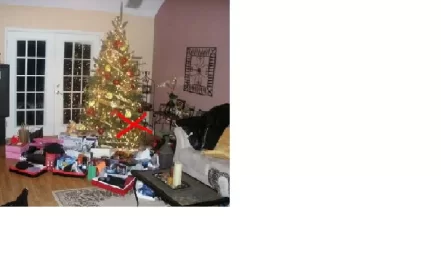

I choose not to install the OAK on my stove. I have read and re-read the post and just can not seem to think that I need it. I live in a 2800 sq ft home with a attached 2 car garage. My home is very open and I have over 7 doors and (2) of them are double doors. I have attached a picture of where I installed my stove (red X), this room has a ceiling of about 18'. I really just don't think that this stove could be drawing in any air. There should be more than enough air for the stove to get in the home without drawing in any more. Maybe I am wrong. If I was putting this stove in a small home or a smaller room maybe. Am I wrong or do you guys think that I am Ok...
Thanks!

The stove must draw in air, since it is exhausting air. The air it is using must be replaced from somewhere. The only reason that the size of the house/room matters, is because the larger surface area of the structure means more cracks and crevices for it to pull air through.
Joe

My question is: How old is your house? If it's fairly new, it was probably built to be pretty airtight. If so, an OAK would be a good thing to add.....the stove won't be able to make the inside of the house a negative pressure area. The stove would run better, plus your not trying to pull air from other areas of the house (like the heating system in the basement which includes CO).
My 2 cents.
Oh, and BTW, I guess your not putting the Christmas tree in the same spot this year.... :lol:
Wife is going to have to find a new spot for the tree! :-) :lol:
My house was built in 1994. I understand that the air the stove is using has to be replaced. Every pellet stove that I have seen around me doesn't have the OAK. My stove puts off great heat. The OAK is a cheap enough and easy install if I decided to do it...just am not sure if it would be worth it. Also wouldn't this increase the chance of rust on the inside stove, from moisture? Thanks for all of the explanations.
