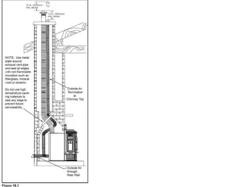

Here is a picture from the Quad Mt Vernon insert (AE) manual showing the full reline with outside air (OAK) specs.
The picture shows the outside air going out an outside wall AND running up the inside of the chimney.
It is not clear from the picture, is it necessary to run the OAK out the outside wall AND up the inside of the chimney or just one OR the other?
Either/Or not both.

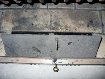

In my masonry fireplace (located on an outside wall), I have a small door in the front of the firebrick floor that when open, provides outside air from a channel underneath the fireplace that is vented (with a screen) to the outside of my chimney.
I have a Mt Vernon AE insert pellet stove on order. If the stove sits on the firebrick floor it will probably cover up this opening. Can anyone think of a way I can reuse this outside air connection for my pellet stove?
Here is a picture of the small door location.
