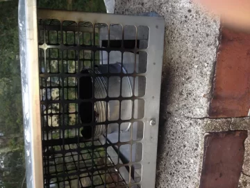

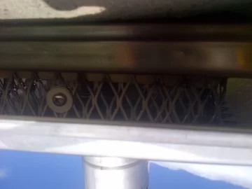

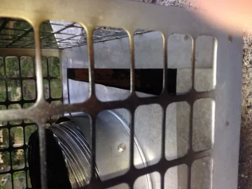

Anyone ever seen this before? Doesn't make sense to me at all. No block off plate which I'm not terribly concered with but this means all heat is lost through the opening!
Installer is returning Saturday to close it completely, but said he left the gap to elimitante smells from the chimney.

No even with the top cap that should be closed off, he may be used to installing smoke dragons. It wouldn't hurt to put a little roxul a couple of feet on top either.
Straight cut on both sides. I bet it was an accidental cut or he didn't have the right part. Put it in anyway and hoped you woudn't notice. I wouldn't accept a patch either, a new top plate that covers the entire flue is the right way and you paid to have it done right.
How many fires have you had so far?
Is the top plate even secured to the chimney tile? One good windy rain storm and you would have a wet stove top. I take it no insulation packed at the top either?
No insulation. It seems tight. I'll go back up after the company comes back on Saturday and see what they did.
No, that doesn't look proper.

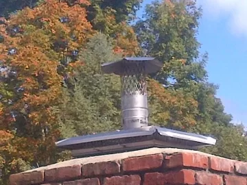

This is how I modified my top plate to utilize my OAK drawing air from the flue-saved $160.00 for a top plate 14" x 18" version. My air gap is only about 1" and I did use a bottom block off plate and Roxul.
