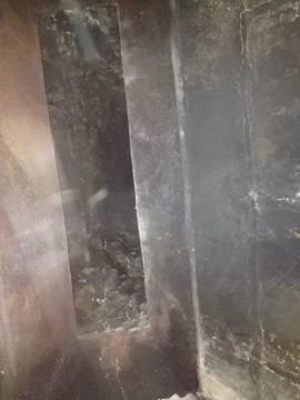

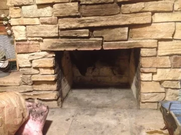

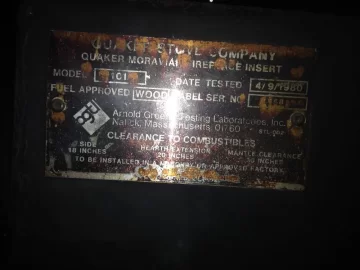

I have taken some pics of the plate on the stove, the stone face of my fireplace where the stove will sit and a pic of up the chimney as best as I could. Inside the chimney there is no flu or flapper, but what looks like metal hooks where one could go.

You need to clean the chimney first and then find the bucks for a stainless liner.
Thanks for the advice. I think we can squeeze the money for the liner. My families safety is top priority. For insurance purposes I am going to go through all the proper channels for permits etc. So I guess the main question is, with the stainless steel chimney liner, can I make this work and not risk an insurance nightmare or the safety of my family? My research is lending to me towards yes, but I'm a first time home owner and just trying to learn as much as I can. Thanks in advance for the reply and knowledge.
It's best to ask your insurance company what they require. Some are ok with an authorized inspection, others want it to be installed by a certified installer and some want their own inspection. Have the stove manual on hand for the inspection process. To do this correctly the chimney must be completely cleaned before the liner is installed. Most installations are safer and require an insulated liner.
