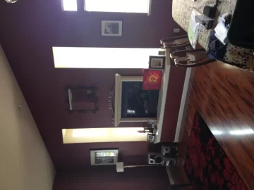

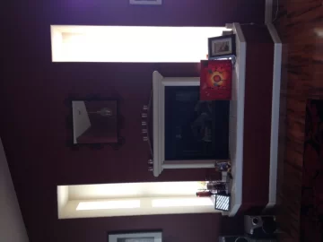

Ok, I still haven't bought a stove and have recently found the Ideal Steel Hybrid appealing.
I've read through their manual and it says no alcove installations.
Would my area where I want to install the stove be an "alcove"?
I'm going to remove a zero clearance fireplace and the drywall and studs around it. I'm opening it up to where there are windows on each side of the recessed opening in the wall.
The measurement of this area is 24" deep into the rooms wall. This area is balloon framed off of the south gable side of the house. 96" wide from window to window, 109" from the floor to the ceiling of this recessed area.
The stove will sit 17" or 18" inside this area with the rest of it out in the room. The 24" depth of this area opens into a large living and dining room which is 22' X 20' in size with11' vaulted ceilings.
The manual says an alcove is any area under 521 cubic feet or 8'x8'x8'...
Does this area I want to put this stove fall in their "alcove" definition? Or am I ok as it's such a minimal area the stove is recessed into???
Here are some pictures. The stove will sit where the zero clearance ng fireplace currently is after I remove it and the drywall and framing around it. There will be a hearth that I will build and extend out for proper clearance.
Thanks

Ok, this is my thought.
This is what I'm looking at, would this be acceptable as my measurements?
The side to side (left to right) is 96" or 8 feet. The up and down is 108" or 9 feet.
The last measurement is the depth which is 24" back but opens into a room for another 20 feet till the opposite wall for 22 feet total.
It doesn't make sense to say no that it won't work because there isn't another 6 feet of depth. If there was then it would meet the 8'x8'x8' rule they have.
I have 24" in back and ample room in front (20 feet).
What are your thoughts with my explanation?
