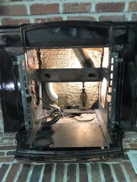

I used double 2in sections of sheet rockwool along the back and sides. ( order it on line as locals don't stock it - its fairly firm and holds up well - comes in 2 x 4 ' sheets and can even get foil backed). Also metal block off plate with 8 in insulation on top.
Exterior brick chimney with the rockwool on sides is not cold and draft free for the Harmon 52i
Picture is not the greatest. Snapped it on install 2017.
