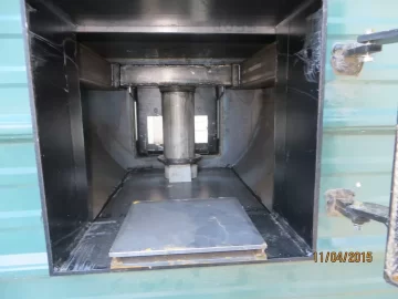

Jason is from New Zealand and had to run around DC to try and find parts to retrofit his device to the old treemont, not a small task. Bylers stove shop up in Dover, DE gave me that stove as they were about to send it to the scrap yard. I fixed up the Treemont for him since he was flying over to the states with only his device. We had to stuff that stove in the back of a station wagon that he was able to beg someone to drive the 2 hours to my house to get the stove. He had to convert it from 8" to 6" for the chimney to work and also weld up a plate over the ash grates on the floor of that stove before he could even begin to work on installing his device. Ohh yea, he also had to get the stove to the competition in the middle of DC.
What he did in the amount of time he had was short of amazing to take a smoke dragon to ultra efficient burner.
I was hoping that Obadiah would have been able to help him more with sales in the USA but I guess that never came to fruition. I am curious how it is doing in other parts of the world.
You guys ask about how it works but it is clearly shown in those threads from Obadiah.
[Hearth.com] Intensifire update?
It turns the old smoke dragon into a downdraft stove which is not my favorite but it beats just having a smoke dragon belching out smoke.

What happens when ash gets piled up around the exhaust gas outlet?

My understanding of the Intensifier is it turns the stove its installed in into a down draft stove. I would think a strong draft would be needed and would work similar to an old VC. The Intensifier itself from what I can see from the limited pics available appears to be two pieces of stainless pipe with an air gap allowing preheated air drawn in for secondary burn setting on a ceramic spacer that allows the gas exhaust to be drawn in and mixed with preheated oxygen to achieve secondary burn. Then be drawn through the flu. Finning tuning would be in the gaps of the ceramic spacer and amount of preheated oxygen to be induced into the secondary burn chamber. We all know the secondary combustion produces lots of heat this is the whole principal behind the modern epa tube stove. When secondary fire is drawn through a combustion chamber I believe it intensifies the fire and the temperature. After modifying my Lopi to try to reduce draft the exhaust gasses and secondary fire is drawn through the gaps in the firebrick above causing them glow around the edges. This to me seem similar to how a high efficiency wood furnace or wood boiler operates. I would like to see what the draft is on a flu with the Intensifier installed. I notice the kent on his website with the glowing flu, I am not sure I would want this in my living room.
