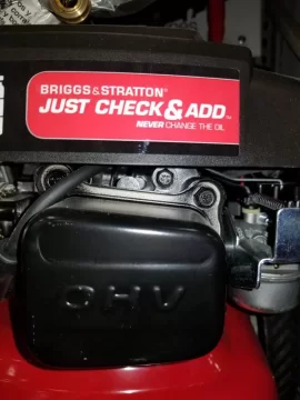

I was looking at pressure washers a lowes. I seen this on a Briggs and Stratton and makes absolutely no sense to me. And how is this good?

I would guess full synthetic. Even so you still get byproducts of combustion and other contaminants including metal from break in in the oil.
The engineers have calculated how much it needs to leak on the ground per month to equate to a yearly oil change.
Thats nothing new to me..lol..thats how I treated all old briggs engines!
I guess they don't plan on it lasting long.i still don't see how that can be good in an engine. It's about as dumb as when small engine companies got rid of drain plugs and you have to flip the little engines over to drain the oil out of them. I guess I'm stuck in my old school ways.
It's stupid. I'm an oil and lubricant nerd, and fastidious with maintenance.
With best break in methods, quality oil and maintenance, those motors will usually last through 3 pumps on those little pressure washers.
If you want a smokey, oil burning POS, then by all means, don't ever change the oil.

Got a power washer like that....looked all over for that damn plug...:) It has a Honda engine on it so I am going to run Honda full synthetic in it...that will run me all season easily.
If you take into consideration the job of oil it is supposed to get in-between every moving part to reduce or prevent friction. If the oil is doing its job and getting between the compression rings and the oil rings then very small amounts re going to be left over and burned, ultimately reducing the oil level in the crankcase. In the past, some manuals considered it normal for an engine to use a quart of oil every thousand miles. Without obvious contamination present, the only way to determine if the oil is shot is through analysis. Many people change their oil long before it has failed. Maybe, the manufacturer's have added new technology that reduces acids, moisture, and wear.
In today's eco-friendly world it makes perfect sense. I'd like to know what life cycle has been determined for the product.

Lol... I would be leary of purchasing it, especially the first or second year productions. This might end up going the way of the horror stories associated with some new products or oil based technologies.
"Never Change the oil", until you flip it over and dump the oil on the ground.
Maybe this is how they got their EPA certification. Maybe it was cheaper to apply a sticker than to recall a million engines due not have drain ports or the sticker was cheaper than retooling a factory.
I had a 1980 Buick that I used full synthetic in after the first oil change and didn't change the oil - just changed the filter every 3,000 miles. Had 80,000 when I traded it.
I am sure it was done on purpose...saves a tooling step and increases engine sales...I will dump it out and change it.
FWIW, here's what B&S has to say about it:
https://www.briggsandstratton.com/na/en_us/campaigns/just-check-and-add.html
Excerpt:
The new EXi engines series from Briggs & Stratton makes lawn mower oil maintenance easier than ever. With improved air cleaner seals, cooler engine temperatures, and high-precision manufacturing along with regular scheduled mower maintenance, the company’s new EXi series lawn mower engine is the first that never needs an oil change.* While the EXi engine requires you to only check the oil level and add as necessary, regular scheduled maintenance must still be performed.

You run enough engines, you can see and smell when the oil is contaminated and thinning down.
I'd use a liquivac fluid changer on that thing after it's broken in, and when it needs changing. Oil's cheap enough, and you can do an oil change in under 10 minutes.
That's planned obsolescence from B & S right there. Guaranteed.

Pretty comical considering it takes 10 minutes and maybe $5 to change the oil on these (and thats with synthetic). Plus you only have to change it once a year, or maybe every other year depending on use.
Exactly. People trusting on the manufacturer's recommendations is a mistake often times with oil and lubes.
There's better lubricants and intervals than what they try to promote, and in this case, they should be ashamed of themselves for saying it's good for "life."
