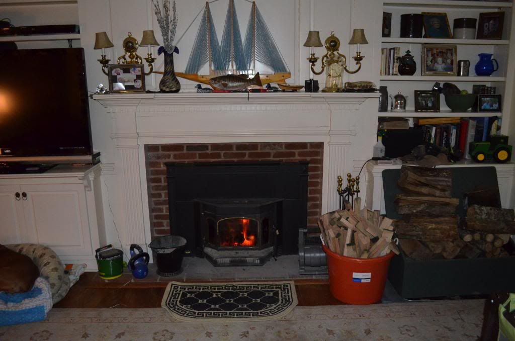

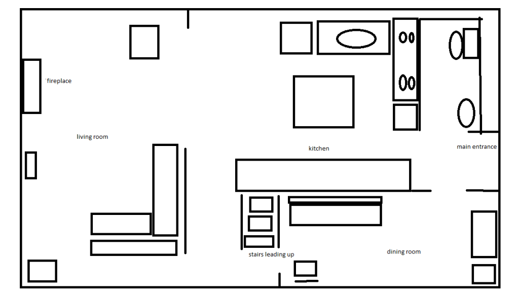

Hello, i have been reading some on your site and i cant quite make up my mind if this would be the right choice for me. I live in a three story 3400 sq ft house but keep the attic closed off. So this would put me around 2000 sq ft. The stove i have now is a quadra fire 4100i insert. The insert does ok but heating the upstairs requires the furnace to cycle all the time. It will keep the downstairs warm without any furnace heat. The reason i ask about the homestead is because i own one at my camp and I am wandering about switching stoves. Would this stove be better suited to head the whole house than an insert. Here are some pics of my setup.:

Welcome and thanks for the floorplan and picture. I suspect the Homestead would not be an improvement here. The 4100 is a pretty serious stove with a 25% larger firebox.
The question I have is whether you are getting the full heating capacity of the Quad. The wood doesn't look that well seasoned, but it's hard to tell from a picture. If it is not, you are only getting part of the heat potential of the stove. These stoves like dry, well seasoned wood. The other place you may be losing heat capacity is up the chimney. Is there a damper sealing block off plate installed?

Good eye on the wood. The wood on the left is 2 year seasoned oak and the wood on the right is 2 month green oak. We have had two catastrophic storms this year that put trees down all over the yard, so i am just mixing in some green wood to dispose of the smaller pieces. I am not sure what a damper sealing block off plate is. Where would it be located? Thanks so much for the help.
I hate to tell you this but burning green oak could be a disaster. It's really cooling down the fire and flue gases. With an exterior chimney this spells creosote. Keep a very close eye on that chimney and don't burn more than a cord of that green wood before a thorough cleaning.
Can you beg borrow or steal some more dry wood? Maybe do an exchange? The difference in heat output from the stove will be major.
A damper seal plate goes in around the liner at the damper level. It keeps the heat radiated from the stove in the fireplace instead of trying to heat the masonry of the entire chimney. Here's an article that goes into a bit more detail. If you click on the links at the end you'll see some installations. https://www.hearth.com/econtent/index.php/wiki/Why_damper_seal_is_needed/

What type of heat do you have? Forced air or radiant? If it's forced air, you should just cycle the fan every so often provided your system isn't zoned (even if it is, it will draw the heat up and circulate it, but not as efficiently). Wouldn't even need the heat on...assuming your insert is even throwing out quality heat with the green wood.
I have a forced air system, with the return in the dining room. I have been using the fan circulation mode on my honeywell th8320 which runs the fan 20 mins every hour to try and get a uniform temperature through the house. The problem being the return is kinda far from the stove and i either loose some heat to get that room warm and let the return have hot air, or close the room off and let the hot air try and go up stairs. I will try the fan mode to see if it helps.

Another question: I am burning that wood box in 24 hours. Is that normal? Just like you see pictured, i have to fill it like that everyday. I usually get a hot bed of coals and then turn the draft down low.
Using the furnace fan system can often be counterproductive unless all the ductwork is very well insulated. Otherwise heat loss can actually cool down the air too much.
As a test, try this. Take the temp upstairs in the hallway. Turn off the furnace fan. Take that grey fan on the hearth and put it at the top of the upstairs staircase on the floor. Point it down the stairs and put it on low speed. Let it run for about an hour. Take the upstairs hallway temp again.
Also, go to the store or find a friend and borrow or buy a full day's load of truly dry wood. You should be able to turn down the stove's air after the wood is fully aflame, or roughly about 30 minutes. At that point the stove temp should rise and stay around 650F for an hour or so.

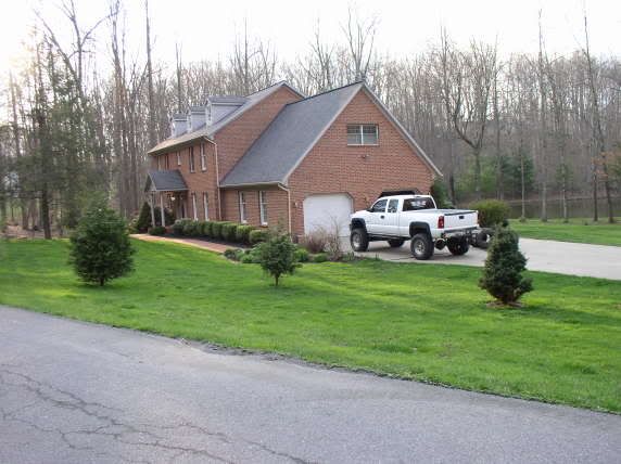

Here is a picture of the outside of the house from a few years ago, some things have changed:

We have had this stove for 5 years. The stove has always been hungry. And does a good job for the whole house till the temp drops below 40*F. Then you have to start running the furnace upstairs.
