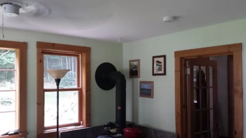

[Hearth.com] Is a smoke detector right above a wood stove okay?
You can see my smoke detector in relation to my stove. Went off once during my learning curve of operating the stove, never since. I actually feel good knowing it's there when I go to bed with the fire cooking along.
