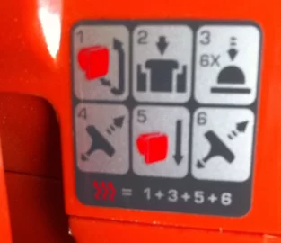

Just follow the procedures on that little sticker to the right of your handle: 1-6 for cold start. 1,3,5,&6 for a hot start (the 3 red squiggly lines = hot start) I do this and have never had a problem. [Hearth.com] Is Husqvarna AutoTune fairly solid at this point?
Just follow the procedures on that little sticker to the right of your handle: 1-6 for cold start. 1,3,5,&6 for a hot start (the 3 red squiggly lines = hot start) I do this and have never had a problem. View attachment 162432
No sticker like that on my Husky 562XP. I just went & double-checked.
I learnt to not use the decomp or primer on hot starts. I do as Pen does, high idle and pull. Saw runs great
My guess is my saw has this sticker because it's a newer saw than yours? (555 built in 2014). It's confusing though because in my manual they include pressing in the decomp valve in the hot start procedure. The manual was printed in 2011 so somewhere between then and now they decided 1, 3, 5, & 6 is the best way to start a hot autotune saw.
