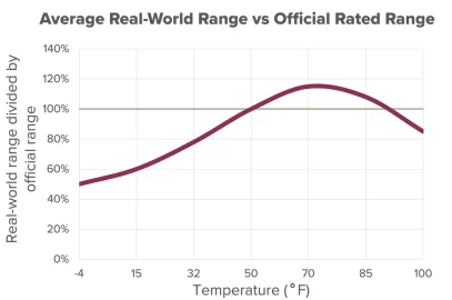

Yes, range can drop to half and deep cold is not good for lithium batteries. Still, ICE engine cars get poorer mileage and less range in the winter too, especially if they are left idling.
