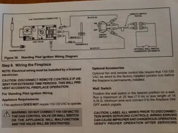

Hey guys, I've been searching threads and can't find an answer. HVAC by nature so I'm figuring my F/P should be easy. Not so. I have a Heat-n-Glo SL-550-c Nat. Gas. Been in the home 11 years and this reared it's head winter of 19'. I replaced the Thermocouple and Thermopile in the fall of 18'. The unit worked fine that winter. Then next fall it started not coming on with the T-stat. If I t/on the tech switch it comes on, stays on if I shut the switch off, and stays on and will go off with the stat. It won't come on with the switch off just using the stat. I replaced the stat (mv of course) same thing. I suspect the switch but by the diagram I want to know if simply jumping it will prove that right. I can't tell if these are SPST or DPST. Kinda need to know if I need to replace it. I'm also curious if you can just bypass the switch and run off the stat. I know it's probably a simple answer I'm stepping right over!

If the switch is bad & you only want to use the tstat, attach
the THermostat wires to the TH & TH-TP terminals on the gas valve.
No polarity involved so either spade can go on either terminal.
You CAN jump the switch - middle spades.
You can also check the switch for continuity, same spot.
the THermostat wires to the TH & TH-TP terminals. No
polarity involved. You CAN jump the switch - middle spades.
You can also check the switch for continuity.
I'll give just running off the stat a try. Thanks.
