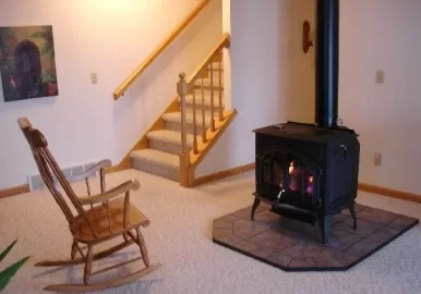

We've got a Majestic fireplace with the glass doors and the circulating fan. Huge firebox. Beautiful hickory mantle.
Eats a lot of wood but will put out some heat in the great room and kitchen. When we figured out that what we had was
not an efficient heater, we opted for the new woodstove in the walkout finished lower level.

Does any of that heat make it upstairs? That's precisely what we're planning (walkout lower level and all)...I'm just having a hard time deciding if we're going to get any benefit from that upstairs...esp with the basement ceiling finished. Do you have a fan/blower/etc to move the air.

Yes, it works with our layout. The stove is installed at the bottom of an open staircase to the great room, so the heat travels
up and gets a push from the ceiling fan at the top of the stairs. I don't have a blower with the stove. The stove has
burned to warm from this morning's fire, and the upstairs is a comfortable 70 degrees. We get an assist from passive solar
on a day like today--20's but sunny.

northwinds said:
Nice IR!

Very nice setup!
