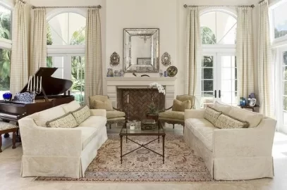

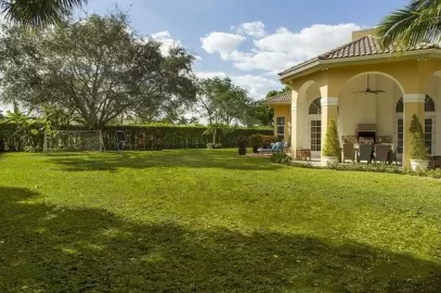

Thanks for the reply. No gas logs, but no door frame either. Don't think this is going to help, but here are two images I found: one of the exterior that shows the chimney, and one of the fireplace itself.
[Hearth.com] Is this a wood-burning fireplace, or a decorative one? [Hearth.com] Is this a wood-burning fireplace, or a decorative one?
If this is Miami maybe it is cosmetic, but that sounds unlikely.
I won't comment on the fireplace, but it sure is a beautiful place...
I sure don't see see any caps on that chase top. I'm really thinking that's a vent free box, that was used for looks. Get a better pic of the top and the fireplace itself and we can say for sure.
