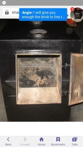

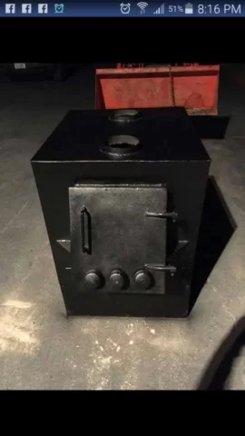

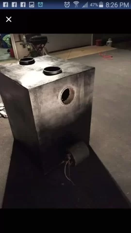

Is this a wood furnace?
LilDave
Nov 22, 2016
29
North Carolina
If so can I use it indoors? I was told I could from the person I bought it from. Any help with any info on a stove like this would be greatly appreciated.

Thanks for the welcome. They got a water stove to heat the house and the water. That's why they sold this one to get it out of the way is what he told me
It's a wood furnace. It should heat 1300 ft no problem. It will probably eat a lot of wood compared to any newer EPA type furnace.
Does it really look like a Hotblast? I thought it looked like something homemade.
Also looks like pretty small air outlets on it.
Think I would class it 'buyer beware', and 'at your own risk'.
Reactions: laynes69
That's a homemade unit. Because it's not tested for safety, strict clearances would need to be followed. I'd hesitate to connect it to my ductwork, like mentioned....use at your own risk. I've seen many homemade stoves, but the ideal of hooking a homemade furnace to ductwork makes me cringe.
The outlets on top are 6". I think it is homemade Firebox is a little smaller than the hotblast. it only has one blower dayton 4C565A.
