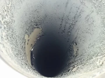

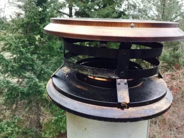

Bare with me guys well I learn. well the stove was cool this morning I checked out the chimney cap is this ok ash in the pipe or is this what creosote building up starts to look like? Also the build up on the chimney cap is normal in the early burn season correct?

Just an amateur opnion, I could be wrong....
The shiny black on the chimney cap is mildly concerning to me, but i don't go up on the roof to look at mine.
I think your flue deposits will probably be OK. That stuff should brush out easily and end up as gray powder in the collection bag. Grey /brown powder is "best". A few flecks of shiny black is OK. A lot of black powder not so good.
Sticky sheets of shiny black is the worst - which brings me back to looking at your cap.
Look forward to responses of others, I am accustomed to looking in the bag of collected sweepings at the end...
Looks normal if doing short burns and it cools off. A hot burn should clean it right up.
How much wood have you put through the stove since your last cleaning?
In my opinion it is hard to assess by just looking down. It is a lot easier to assess after you clean and can examine exactly what the creosote looks like.
My guess, I don't think the cap and the chimney was spotless at the start of this season. The cap looks like mine, which I removed the screen. I take my cap off every year and clean it. After a full season it's dirty, but not as bad as yours. That said, yours is not to bad. If this is new to you this year, learn how to clean chimney, and check it occasionally. Marginal wood, will burn but will gunk it up rather quickly. Not a problem if you clean it.
Looks like there was some cool burning shoulder season fires or some less than fully seasoned wood burned. Regular hot full stove fires should clean things up if the wood is dry. I don't see anything alarming at this point. It's good that you're keeping an eye on things.

Learned first-hand bad burning and good burning. What I see would not concern me. Gray flakes are fine, the cap will naturally be the coldest area and might look like that a few times a year.
Look for: not black residue, certainly not sticky/wet-looking.
Easy check on how you're doing is to go out and see what smoke is coming out of the chimney: black, blue smoke is bad; you're choking out the fire and the flue gases are too cold (incomplete burning). White smoke is good and normal at first (enough air to burn and things (stove/pipe/chimney) are heating up), and then no smoke is great/cruising.
Then you have to be wary of overfiring, where a thermometer is handy.

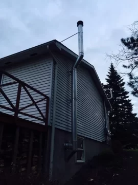

How do I go about cleaning my chimmny? I've watch a couple YouTube vids and read a few things on here. My outside pipe seems straight forward other then will the bends be a problem pushing a brush past? Brush top to bottom. [Hearth.com] Is this ok  in my chimney or should I be watching very closely

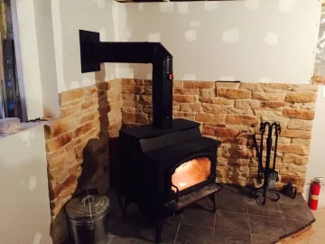

It's the inside set of pipes I'm not do sure on. From the clean out t to the stove. Here's what my pipes look like.

I think I would brush that bottom up, through the bottom of the tee. Then detach the interior pipe and brush that separately.
If you're asking what I think you're asking you just undo the screws on the interior parts take them off and clean them. Than re-assemble. Atleast that's what I've always done.
How do I go about cleaning my chimmny? I've watch a couple YouTube vids and read a few things on here. My outside pipe seems straight forward other then will the bends be a problem pushing a brush past? Brush top to bottom. View attachment 168720
My chimney looks almost identical to this right down to the offset to clear the soffit. Always thought that brushing from the bottom would be the way to go since it's super easy to open the cleanout to get access, but what about the cap? If I'm careful enough and get the brush into the cap and give it a few turns would that be sufficient?
That depends on whether it has a screen in it and now dirty the chimney is. For light fluffy stuff the cap cleans pretty easily. For gooey creosote, not so well. Our cap screen went 8 years with little clogging and then we had a winter burning soaked maple. The cap clogged within a month. I had to pull the screen to finish out the winter.
