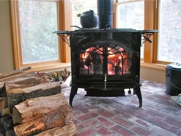

Life is good in No. Cal. this morning with the IR going and a little snow on the ground with more coming.

Hey Jim, nice pics. What color is your stove? looks like enamel black, looks nice. What kind of wood are you burning? appears nice and dry-I see the cat has a nice spot. Just love your install with the corner and the windows.

Our stove's color is mahogany although it's pretty dark and in the shadows looks like a black stove. It had Oak in it during the photos although we mix it with Pine occasionally. It sounds like your stove is burning very efficiently and keeping your warm. That's what it is all about!
