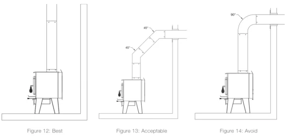

It sounds like this could be a combination of factors. The chimney liner may be better sized to the larger Defiant, the chimney takes longer to warm up due to the lack of an insulated liner and the 90º turn is spoiling draft. All this becomes more apparent as the flue gases cool down when running with the cat. A remedy would be to install an insulated liner and change over the 90 to a pair of 45s in offset configuration.
