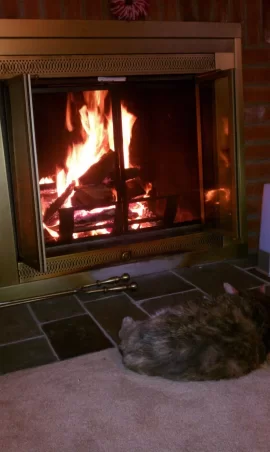

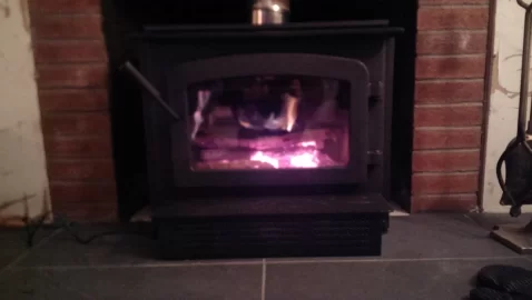

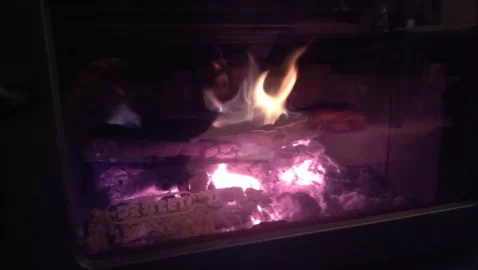

Well,
I have to give everyone on Hearth.com a big thanks as I would not be sitting next to my new fireplace insert today without everyone's input.
I got my new Drolet 1800i fireplace insert installed today and I am amazed at the difference in house temp already.
I though I would recap my experience for other newcomers.
1) Find dry wood (20% moisture content)
2) Find dry wood not seasoned wood
3) No one sells good dry wood cheap. Buy a moisture meter to confirm good dry wood. Split wood before measuring with a meter.
4) I waited on buying an insert until steps 1-3 were done :)
5) Ask a lot of questions on Hearth.com installing a wood stove is not as hard as it sounds.
6) There is no one perfect stove that everyone will agree on and for every stove someone will have had an issue with it.
7) Read the manual before you buy the stove or insert. Measure 3 times to make sure it will fit and that you have all of the minimum requirements met.
8) Micore is hard to find but worth it if you need a near to the floor hearth.
9) Installing a new flue and insert is a dirty dusty job. Have plenty of face and hand protection.
With that said here is what I used for my install.
1) Fireplace Insert - Drolet 1800i (bought online)
2) Liner - Magnaflex InsulFlex Insulated 6" liner (bought online)
3) Hearth - 1" of Micore + 1/2" Durock + Slate.
From to now
[Hearth.com] It's Done.... [Hearth.com] It's Done.... [Hearth.com] It's Done....
Now time for a libation and to watch the secondaries!

Nice summary and good advice, I assume you made a block off plate with the micor?

Weatherguy...the Micore was used for the hearth to give me the R value that i needed. The block off plate has Roxul stuffed up above it.
Adamkry... Warmth outweighed risk... :) At least the flu waited until after the flue install...
Jags... Yup i did a block off plate and stuffed Roxul above. It works great just like everyone said. The only downside to the stove so far is that the room is too hot!
