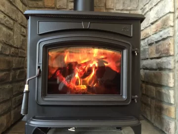

burn in fires are history. Here is our F55 cruising at 500+ secondaries are kicking in and it's getting toasty! Will take some time to learn everything but our wood burning venture is in full gear!

Nice! I love the clean glass too! You must have some well seasoned wood available.
Reactions: Creekheat
When we first decided to become wood burners I tried to be smart. I purchased what I thought would be a one year supply of good split seasoned oak. 3 cords. The. I cut and split another years worth myself. About 3 more. I figure you should get the wood first so it has time to season properly. Now I can start to rotate wood and always have stuff that's about 20% MC and seasoned about 1 1/2 years. Made sense to me anyway.
My neighbors all laughed when I was collecting wood a year and a half ago with no stove but I think they get it now. ;-)
Thanks webby. I appreciate a compliment from people far more experienced than I. :-)

Beautiful..............
Looks fantastic! Thanks for posting a pic, now we all know it really happened [emoji6]
Beautiful fire there Creekheat. Enjoy the warmth!

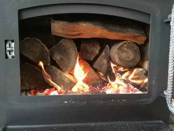

Does this seem like a low enough coal bed to reload or should I let it coal all the way down? It's about 2" deep pretty red. Running about 250*
[Hearth.com] It's official. [Hearth.com] It's official.
250F should be low enough for a reload. Give it a try and let us know how it works out. Or rake the coals forward, put a couple 2" splits on them and open up the air to burn it down quicker while still putting out some heat.
I raked all the coals forward into a heap and it flared right up. I left the air control open for just a bit and it jumped back to 300* I'm going to let it roll about another 30 min then try for an afternoon reload. I was starting from a cold stove so I had some kindling and paper in there next time I should be able to stuff another 3 splits in. ;-)
I just have anxious stovitis! Lol
