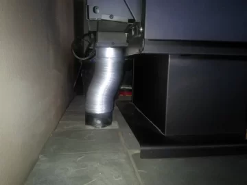

I'm still toying with the idea of getting the blowers. I think I'll rig up my own OAK; I was able to look over the floor model pretty well when I was down in Eugene, and got an idea of where all the ports and removable plates were. What did you decide on all that?
We went with the fans, no OAK. I figured I can install the OAK later if needed, but it's going to be a pain because I have to drill down through the brick hearth.

I was ready to install an OAK if I needed one, doing fine without. Depends on how tightly sealed your house is. If you are running an HRV you will probably need either an OAK or an HRV outlet near the stove. Otherwise, wait to see if you need it before you start buying parts for it.

The standard US OAK kit is 3" pipe. The Canadians use a 4" pipe. I used rigid duct for mine and did it in 4" so I had to get a hold of the Canadian OAK. Here's a pic. I like it. Heck, earlier this week I was going to start a fire in a cold stove and the wife had the range hood blower running and it actually sucked flue air/ash out of the open stove door until she shut that thing off. My 1963 house is not tight but these things need excellent draft. Part of getting excellent draft through the stove is assuring sufficient inlet pressure.
I never really considered an HRV; don't these stoves have fairly low flue temps to begin with? Either way, I think I'll take your advice and forgo the pricey cost of the kit. I may rough in a vent when I tile the floor since it'll be easier that way. If I decide I want to use it, I might not purchase the $90 kit anyway. I'm sure I can adapt a round duct to a square hole for a lot less than that! Other components of this project are starting to add up fast anyway.
