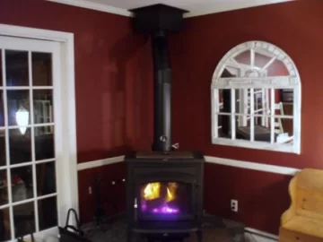

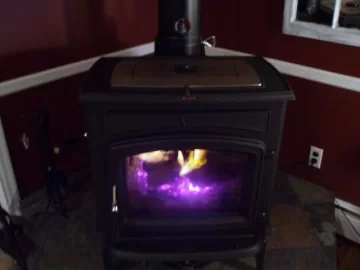

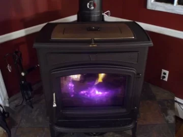

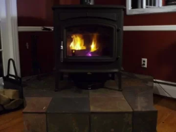

Here are some Rangeley pics as promised. Small load, primary closed halfway, 350 deg stovetop, secondaries just kicking in. Just added another two splits before posting this...getting warm in here. Need a cold Molson.

Thanks for posting the pictures Jim. That setup looks very well designed. May I ask if you got the cast iron sides? I'm debating weather to get the cast iron sides, and wonder if they are necessary. Also I think about installing a possible side shield, and think the cast side would not be visible then. Are the cast sides removeable if one decides they want to remove them. I really enjoy the purple flame. Hope I can get mine to do that!
Great looking install. Keep us updated, I think your the first person here with the new Jotul. Have you filled her up yet and seen how long she can go?
I have the cast iron side plates. When I first heard the dealer would be able to get the stove in mid- December I asked for the steel sides and planned to use the savings on the blower. Jotul was only making cast ones initially and would not have steel sides available until late January. So I think they want to get the better looking stoves out on the market first and then send some steel sides out. With that being the obvious benefit of cast, it looks much nicer and completes the lines of the stove. I am glad I have them, the stove looks all cast at first glance. I found a bolt under the plate if you had to think about removing them but also think you would have to get past the firebrick from inside to actually loosen them. I filled the stove at midnight and closed the primary 3/4 and had a ripping wood coal bed at 8:00, so I think 8-10 hrs is a given. I burned some higher moisture content wood and that immediately dirtied the glass, hence the purple haze effect in the photos. I am burning white ash primarily and will be counting the year(s) to when my oak will be ready. I tried some bio bricks too and wow, those babies burn baby burn and last. To all here who posted about using wood ashes on a damp cloth to clean the glass, thank you, no need for anything else!
Great pics . . . love the purple flames . . . can't say as though I've ever seen purple flames in my Oslo.
YEA, I love the pictures. Hope Jim post more. Does anyone know about the constrution of this stove? Plate steel thickness? Jotul has no way of contacting them, or a FAQ page. You would think that with a newly introduced stove they would be tooting their horn about it, and dishing out good tidbits of info of it's quality construction. I've seen the Lopi Endeavor up close. It's built like a M1A2 tank. Extremely well constructed, and heavy, heavy duty unit. Jim, could you get us a few pictures of the sides, and possibly the corners, showing the front, and side view. The front door handle looks stout, and very well positioned. Do any Jotul dealers ever read these pages? Answer questions?
The sove looks great in place and burning. Great to hear that it is working well. Are you mostly top loading? If you get a break in the weather, could you measure up the firebox and post the dimensions?
Love the digital camera color balanced flames. Looks like it's sensitive to infrared.
The video mentions loading 20" splits E-W and 18" splits N-S, and the stove weighing over 500 lbs. - I'd think the firebox must be at least in the 2.5 cu ft range.

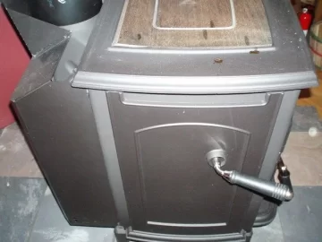

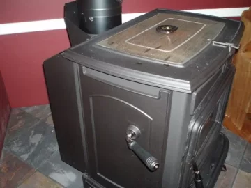

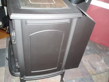

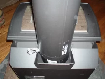

Firebox measures 20" W x 20" D x 15" H. That tape measure got HOT. These pics are of the sides and rear, sorry about the peanut oil splatter on the cooktop...thats the price you pay for frying Spicy Panko Blackfish.

Thanks for the pictures. That's a might fine looking stove. By my calculations that fire box is 3.2 cu ft! That's a biggin, must be about the same size as the Firelight? Should be able to heat well over that stated 1600 sq ft.
Va-Va-Va-Voom! That Rangeley is absolutely beautiful! Thanks for the pictures Jim. My calculations come up with a 3.472 cubic foot fire box. By firebox standards that looks to be a large one. 20x20 = 400, x15 = 6000 cubic inches. 6000 divided by 1728 (12 x 12 = 144 x 12 = 1728) equals 3.472 cuft. Almost a 3.5 box by my math.
Am I missing something as to how fire boxes are calculated? Do we then go to a 95 percent overall. Stating a 5 percent reduction for other components inside the stove?

Found this thread on firebox measuring, Jotul 400 woodstove discussion.
https://www.hearth.com/talk/threads/50986/
So 3.2cuft is more accurate in accordance with Jotul standards.
Still a Vopper firebox. Yippie! The Harman states a 2.3 cuft box. Wonder how they measure theirs.
