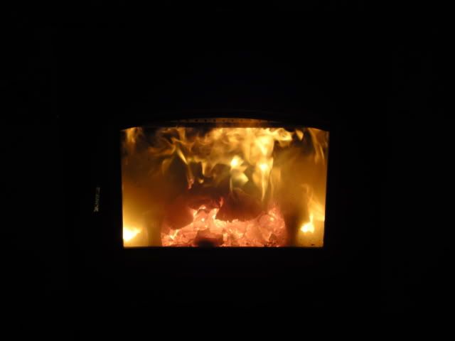

You're not alone Ohio. That's why I modded my version of the stove too.

I have been thinking that Jotul could also offer this stove, steel sided, with 4 each, either 1/4", or 3/8" nuts welded on each corner, of both steel sides. Then you could attach a decorative side heat shield, allowing for additional upwards convection currents, and closer safe spacing from a side wall. Jotul could offer just a simple plain heat shield, or a animal stamping, of which they seem to be fond of in some of their cast designs. They could bend the top of the shield over 90 degrees, allowing the rear fan to then push the heat out towards the room. Get the heat out where it will do most good. Different side selection to cater to tastes, and needs.
