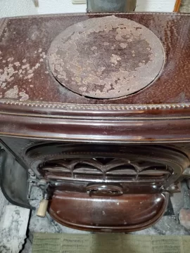

Hello,
I have smoke coming out of the top of the gasket smoke outlet on my Jotul 3 stove. I use the back so the top isn't used. I can't seem to find anyone having the exact part number that I need. Is there any other option or tricks I can use to stop it from leaking?
[Hearth.com] Jotul 3  gasket smoke outlet [Hearth.com] Jotul 3  gasket smoke outlet
It looks like there’s a disc of some sort under it. Part 19. I iont think that’s a gasket.
But if there isn’t a cover below it, and no gasket, I’d look to see if it could be bedded in furnace cement.
I have one. no disc below, it must be a gasket. That round plate is designed to be switched from top to the back depending on flue placement. it switches position with the flue outlet piece. (which I'm gonna guess is part 96 in drawing.)
Actually i think it attaches to the rear flue collar which stays in place? And 96 would be needed for top outlet.
Reactions: all night moe
I don’t imagine they’d be changing gaskets too often. I’d be surprised if the part wasn’t readily available.
