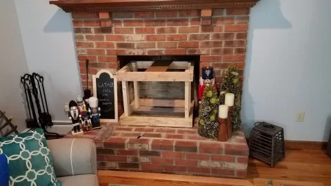

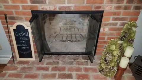

Hearth, nothing int it:
[Hearth.com] Jotul 550 or Osburn 2400

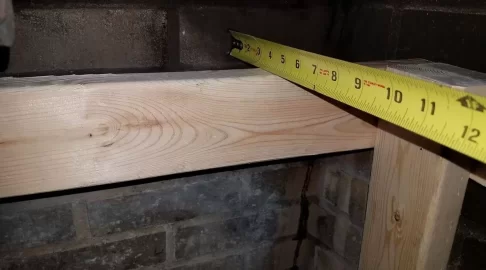

Here is a representative cube of what will be going in the hearth.

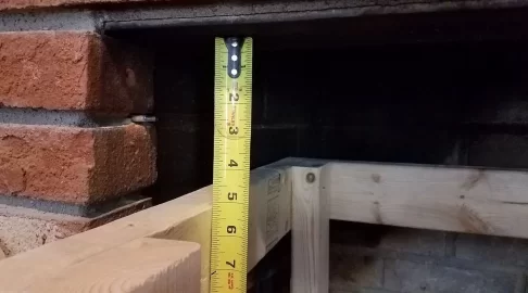

Clearance from lintel to top of insert: 5 inches

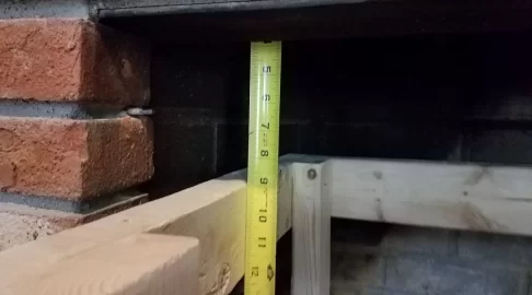

Clearance of smoke shelf behind the lintel to the insert: 9 inches

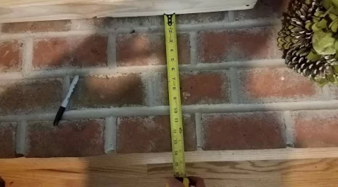

Back of insert distance:Bottom Roughly 6.25"
Top: Roughly 3.25"

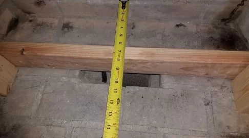

And for kicks, the distance from front of insert case to end of hearth: 14"
