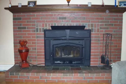

The mantle shield alone "appears" big. When installed, it is virtually unnoticeable to me and others that visit my house. It slides right behind the surround. I had to have it due to clearances. Not a big deal at all.
Here is a good photo of mine with heat shield.

I ran into this dilemma myself. For the installers to install that day (with no heatshield) we removed the mantle so my choice is between ripping the mantle narrower, or raising it. In my instance I only need to go about 3/4" so I will probably do that but the way mine is mounted might create some issues. I think I will take the oppurtunity to upgrade the mantle at the same time, thinking about a hand hewn 6x6 or 8x8 would be really nice!
I'll agree with Sen. John. The mantle shield is no big deal. I don't even notice mine anymore and it is bigger/longer than the one in Sen. John's picture. Plus you can remove it when the stove is not in use during the summer.
Funny. That works better than I'd have thought given the description.
