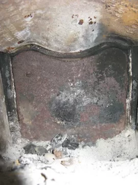

I made a simple steel plate back and used a nut on the #10 screw to space it from direct contact with the stove back. The whole thing just uses up about 1/4" of firebox space. I'll try to post a picture. Not the greatest shot, but you can see the plate in the back. Getting a bit rusty, the stove has been in the garage for several years. Needs cleaning too!

I love the idea of how you made the rear heat shield, I'm going to try and mimic what you have done. It looks as if you actually rounded the burn plate to the baffles shape in the picture.
