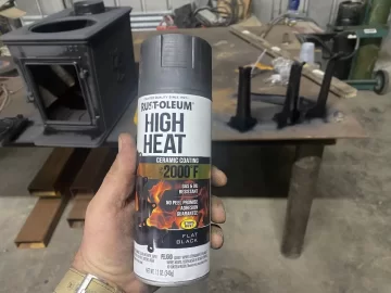

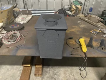

A little bit of wire wheel, and a bit of paint. Might be a few dark spots yet. I didn’t wait for it to dry 100%. Goes on a glossy, dries flat black with a hint of gray. I buffed the burner, but left it unpainted. Didn’t really see the point.
No Milwaukies we’re harmed in the making of this post.
[Hearth.com] Jotul 602
Wire wheel above. Then paint below.
