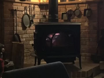

Yes, It is equal in both directions it goes all the way to the + and back to the - on mine. My stove top on low will be 400ish according to the Rutland. This is with a nice slow bluish flame from the secondary’s and a light red glow from the cat.
Wow, that looks great. Where is the cat located in your stove?
Right above the door.
Wow, it must contribute quite a bit of heat and can probably allow the stove to be run lower if anything. The cat itself must act like a baffle which would add more turbulence and allow a greater chance of gasification Ignition as well. Seems like a home run for Jotul.

Wellll maybe. The stove has no bypass so everything goes through the cat all the time. No one has been successful in the past without a bypass. Only time will tell.

I’m all for the addition of the catalyst, and am hopeful it holds up. It’s huge, nearly the entire width of the stove. If it fails, it will be very costly.
My Oslo would run really low, but after a little bit it would lose secondary combustion and start smoking, unless the air was increased. Since the cat has thermostat controlled secondary air, hopefully it can run on low without smoking. If our V3 had low...
