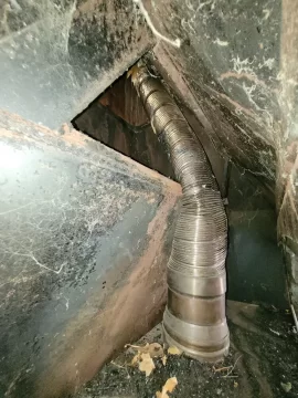

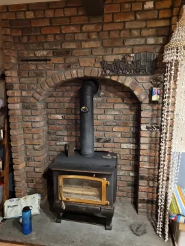

Sure thing, thanks for your advice - I was mostly focused on thumbs up/down for f500, but there's a lot of no here so I should start thinking seriously about alternates.
Horrible Liner install. Exterior was caked in creosote and insulation. Block off plate was a jenga stack of fire brick. Resized_20220810_112823.jpg
Combustibles have been removed (clock, box, bongos). Eventually want to replace this shiny mica filled stone with brick or something.

Thanks, that helps. There are several inserts that come to mind that would be a nice visual improvement. How large of an area is this heating? What is the lintel height?

Unless you set the stove completely Infront of the fireplace you will be better off with an insert. They are designed to direct the heat out of the fireplace stoves are not.
