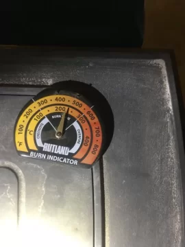

This is not an issue of a radiant/convective stove. The stove should run at about 650º stove top. Put the thermometer on the stack about 18" from the flue collar and let us know what it reads. It may be that too much heat is going up the stack. If so using the key damper in the stove pipe should help quite a bit.

I will get another stove thermometer to show flue temperature vs. stove temperature at different points in the burn cycle. All I can say about my operation of the draft control and damper is that it follows common practice and the owners manual, full open at start of the burn and then close it down about 15-20 minutes later. Generally I close both the damper and the draft control fully down, but if the fire didn't start as strong as I would like I leave the draft control 50% open until the fire hits that mark.

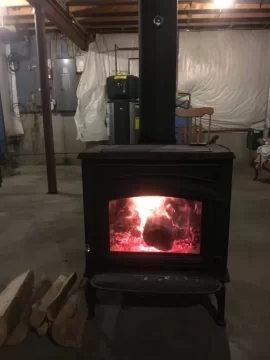

Can you post a video of your burn when you've started to shut things down? Maybe some pictures of your setup?

Thanks. The flue temps are a good next step. I would also verify the stove thermometer is relatively accurate. Some can be off by quite a large degree.

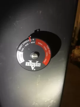

So I went out and bought a new thermometer for the stove pipe. It is a Ventis brand that measures the actual stack gas temperature, rather than that of the metal pipe. I started a fire about two hours ago and the basement was at about 65 degrees. Ran it as hot as I could and put in fresh splits N/S as needed. Although I only have one wood moisture meter that I bought from Lowe's and therefore cannot vouch for its accuracy, I don't think that the problem is wet wood. All of my wood is in a wood shed and has been since at least June. The wood itself, according to my firewood dealer, was cut and split in the summer of 2017. All I can say is that I know what wood that hasn't been properly seasoned burns like, smells like and feels like, and this isn't it.
The fire has now been burning for 2.5 hours. I've tried running it with a cellar window cracked open for more air and with different combinations of the air control and the flue damper. The only observable effect is that the air control has speeds or slows combustion the quickest (obviously) and the damper seems to slow the combustion while keeping the temperature up.
After 2.5 hours the stovetop is cruising at 450 degrees after peaking at between 550 - 600 for awhile and the flue gases briefly hit 1000 degrees before settling at 750 degrees where they are now. The basement temperature rose during that period from 65 to 76 degrees and the first floor went from 65 to 68 degrees. All this while the outside temp is 50 degrees and rainy.
If this was my old stove, it would be very warm throughout the basement and into the second floor. I guess the only thing left from the above suggestions is to find a manometer and check the numbers on the flue draft.
