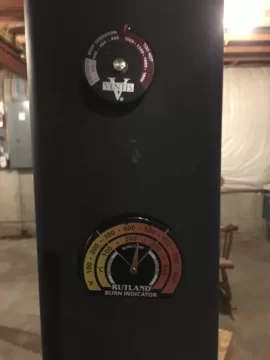

So I went out and bought a new thermometer for the stove pipe. It is a Ventis brand that measures the actual stack gas temperature, rather than that of the metal pipe. I started a fire about two hours ago and the basement was at about 65 degrees. Ran it as hot as I could and put in fresh splits N/S as needed. Although I only have one wood moisture meter that I bought from Lowe's and therefore cannot vouch for its accuracy, I don't think that the problem is wet wood. All of my wood is in a wood shed and has been since at least June. The wood itself, according to my firewood dealer, was cut and split in the summer of 2017. All I can say is that I know what wood that hasn't been properly seasoned burns like, smells like and feels like, and this isn't it.
The fire has now been burning for 2.5 hours. I've tried running it with a cellar window cracked open for more air and with different combinations of the air control and the flue damper. The only observable effect is that the air control has speeds or slows combustion the quickest (obviously) and the damper seems to slow the combustion while keeping the temperature up.
After 2.5 hours the stovetop is cruising at 450 degrees after peaking at between 550 - 600 for awhile and the flue gases briefly hit 1000 degrees before settling at 750 degrees where they are now. The basement temperature rose during that period from 65 to 76 degrees and the first floor went from 65 to 68 degrees. All this while the outside temp is 50 degrees and rainy.

The flue gases are too hot. Too much heat is being wasted up the chimney. Ideally the flue gas temp would be equal to or around 100º less than the stove top if everything is working right. Our stove cruises with a ~ 500-550º flue temp and 650º stove top after the air has been closed down.

The thermometer is in the black single wall pipe that leads to the Metalbestos chimney, about 20" above the stove. It is positioned per instructions over the damper which was open at the time. It sounds like the conclusion here is that there is too much draft for the stove and it is sucking the heat up the chimney.
Still uncertain. That's the wrong thermometer for single-wall stove pipe. A probe thermometer will give erroneous readings on single-wall. It is calibrated and designed for double-wall stove pipe and will read too high. Put the stove top thermometer on the stove pipe about 24" above the stovetop. Let it settle down and take that reading.

You might be able to rig up a heat shield for your flue thermometer out of a piece of can to simulate double wall pipe.

I added another Rutland thermometer to the vent pipe to check that temp against the stove top. This morning I started a fire with mixed Ash cordwood (17% moisture) and some dimensional lumber out of my scrap pile. I got a good fire, with the secondary burn system working as designed and achieved temperatures of 550 degrees stove top (it peaked a bit after this photo) and 450 on the flue. This lasted for about an hour or so and then died down to 250 degrees and below. The basement temp hit 73 and that was it...
Not sure of where to go after this.

450F surface temp = about 8-900º internal. Surprisingly the Ventis probe is not that far off from this. Too much heat is being lost up the flue. With a full load like that you should be seeing ~650º stove top temps for an hour or two and 250-300º surface temps on the stove pipe.
