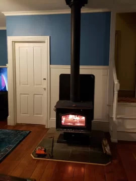

It's a 2000 square foot 1870s farm house. The ceiling between the second floor and attic is insulated. The house is triple brick construction, the walls are at least 12 inches thick. Some windows have been replaced and some are original yet. The stove is located at the bottom of the stairs going to the second floor. I have ceiling fans in almost every room in the house and have been using box fans to help move some air. The kitchen and back bathroom are always cold but I dont think I can do much to help that other than using a box fan to help blow some heat back there. The kitchen and back bathroom were an addition on the house, theres a doorway separating the kitchen from the living room where the stove is. I ended up purchasing a Jotul F500 oslo last weekend. I think the F55 or F45 would have not only been too large to fit in my house but I think it would have also overheated my living room. Once I saw how large the F500 was I decided it would probably work best. Just hoping I can keep it going while sleeping and while at work because my current stove only burns about 4 to 5 hours.
This is my current stove. I will be taking it out, doing all new tile on the floor and installing the Oslo next week/ weekend

BTW, what make and model is the old stove?
I tried blowing the cold air towards the stove room and it seemed to take some airflow away from my stove and made the fire die down, as soon as I turned the fan off the fire began burning brightly again. And the old model is a century cfm model FW270029
