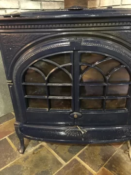

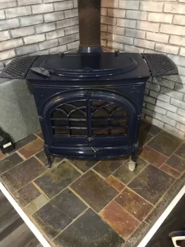

Hello everyone,
New to the forum here. I will debut with many questions about my wood stove.
We moved into this house 3 years ago, the wood stove sat in th basement unused since we had no idea if it was safe to use. I finally had the flue inspected and it looks squeaky clean, the tech said the stove looks good and other than needing a new damper gasket it should be safe to fire up.

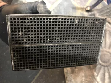

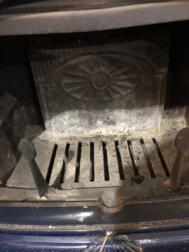

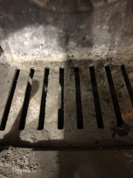

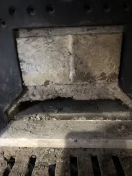

I am attaching some pictures of the interior of the stove. My questions:
1. Do you guys think everything looks in order? I am specially concerned with the cat combustor.
2.I read plenty on the wood x ecobrick dilema and wondered what would be easier for someone with zero experience heating with wood.
3. The manual doesn’t mention the size of the gasket for the damper. Anyone would happen to know if 1/4 is the one?
The stove seats in a basement, we plan on using as a supplement to our obscenely expensive electric heat. I plan on cuting vents of the floor for cold air return and hopefully enough heat will make it up the basement stairs.
Thanks!
Leo
[Hearth.com] Jotul Firelight 12 Newbie [Hearth.com] Jotul Firelight 12 Newbie [Hearth.com] Jotul Firelight 12 Newbie [Hearth.com] Jotul Firelight 12 Newbie [Hearth.com] Jotul Firelight 12 Newbie [Hearth.com] Jotul Firelight 12 Newbie [Hearth.com] Jotul Firelight 12 Newbie
The cat is partially plugged and needs to be gently cleaned. Try brushing with a soft brush and vacuuming.
Or a soft pipe cleaner.
Marking for later discussion. I owned three Jotul Firelights, until just a few years ago. Yours is in the later years of F12 production, as evidenced by the doghouse door.
