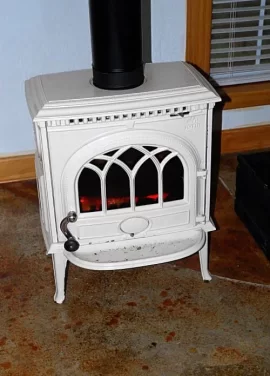

Hi there, we bought and installed a Jotul F3CB in our newly-built home. It's working hard this winter as the sole source of heat for our 2000 sq. foot house.
We had to store it (well-covered), outside for a few months during construction. With the humidity in South Louisiana, the already chip-happy ivory enamel has started to get quite a noticeable number of chips, especially around the legs. I found one site on the internet, Harworth Hearth in the UK, selling Jotul ivory touch-up paint.
(broken link removed)
Does anyone know of another source? It would be nice to buy more than a smidge.

Did you check with your Jotul dealer? This should be a factory item.
PS: How did it chip?
Yes, that would be my question, as well. How and why did it chip? I'm especially interested in the answer since we're about to purchase that exact same stove (also in ivory). It's also curious that Jotul notes that only the ivory F3CB arrives from the factory preped for a rear stove pipe. All of the other colors come preped for a top stove pipe. I know that it's easy to change that around but why the difference? Is ivory more prone to blistering or chiping?
Chip
In my experience this stove is very prone to chipping, both due to humidity and scuffing due to normal wear and tear. I think you'll see that experience with porcelain enamel echoed by others.
Now, if I could just be linked to some touch-up paint...

The newer Jotuls use a different kind of enameling process. It is thinner, but tougher, less prone to cracking and chipping. I'd have to work at chipping the finish on the Castine. No argument that this F3CB is chipped, but I wouldn't call Jotuls 'chip-happy'.
So what happens to a non-enameled stove in this region? Major rusting?
No doubt, cast iron rusts pretty quickly in 98% humidity at 95 degrees farenheit when stored outside during the summer, be it enamel or matte black. That said I'm very happy with the stove and get lots of compliments. We live in the woods and I cut my own firewood, so we weren't looking for the stove to match my iPod ;-)
