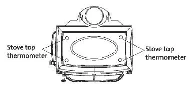

It does seem to be tricky knowing when and how far to turn down the draft. The flame pattern and stove top temperature on front right corner don't always result in my knowing if there will be smoke coming from the stack. If I damper it down and the stove temp starts dropping fairly quickly there is a very good likelihood I will have smoke. Maybe I need to measure the temp on a different corner, the top middle, or my flue pipe. It's kind of a mystery still!
This is where Jotul recommends the thermometer be located on the F500.
