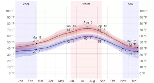

  • We rarely go below -5°C (23°F) and are almost always above 0°C (32°F) - (year round temp profile below)
