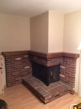

Here is my neighbor's Fireplace:
Majestic
M36, MD36, MD36R, MD36L, M28
Will post mine shortly.
  • [Hearth.com] Just had a fireplace inspected and have more questions than answers...

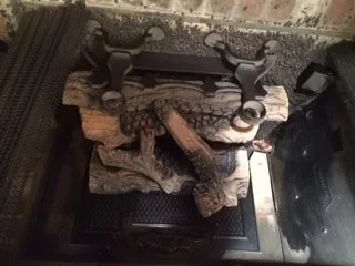

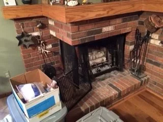

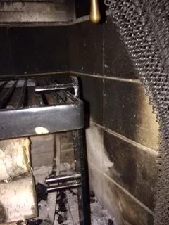

Here is mine:
Majestic
Models: L42B, L42BR, L42BL, L36B, L36BR, L36BL, or L28B
