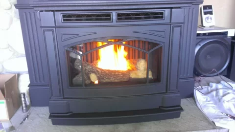

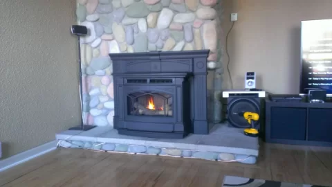

just installed a new regency gc160 insert
joedirt
Dec 9, 2009
31
gresham, oregon
so far i love it,..just thought id post a few pics of it
  • [Hearth.com] just installed a new regency gc160 insert
Looks great! Congrats on the new stove.
Nice. It's amazing how similar that looks to my Hamton 300i wood burner.

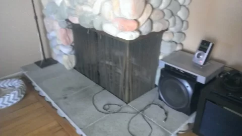

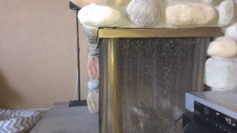

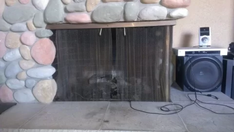

some before pics of the odd fireplace...im still working on a side access panel
previous owner installed a gas line and fake logs..i hated it and it just waisted money
