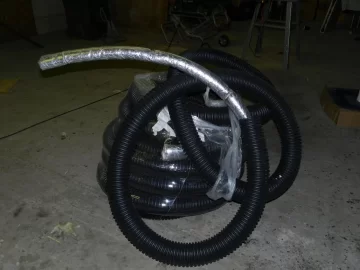

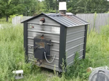

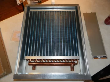

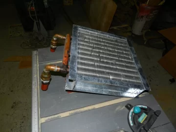

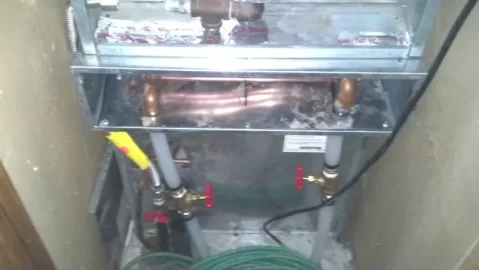

well its been a couple weeks but ive got everything coming together here real soon here are a few pics...ive got a backhoe coming this week to dig trench and my hvac guy is coming this week to raise my furnace and add a exchanger...i got better pipe to go to the house and i put together some pipe for the barn..i know its not the "way" but i gotta cut corners somewhere....first pic is the cabinet and the exchanger for the house..2 is stove of course 3rd is the pipe i put together for barn and forths is house pipe off ebay and th is the exchanger for the barn i just need a fan for it..... any suggesting?
I agree,,, I had the exact same stove years ago... and that pipe... You'll be shocked and disappointed when you see your stove cycling like every 45 minutes and see how fast the full box of wood is gone.. You'll be digging that back up... And I had radiant heat with mine .. Forced hot air your going to be using more heat.. Buy the good stuff and do it once or search on here about spray foaming the pipe in your ditch.. Best is to run 2 feeds and 2 returns in two separate pipes. Then the cool return water is not pulling heat from your hot feed.. You'll cut your wood useage down big time.. Your in ground pipe work will determine your yearly wood usage and how much you fill the stove.. Remember,, once you've made a decision on the quality of your pipe install,,, you can change nothing about your wood usage unless you dig everything back up.. You might fill your stove twice a day verses three times depending on your pipe to ground heat loss... If your heating the ground, running that stove is going to get old quick... I had a hole get in the same outer pipe that you have and moisture from the ground got inside my pipe.. , when it was like 10 degrees out , I could watch my boiler water temp drop like 10 minutes after it had just shut down from topping the water temp off... That's when I knew things had to be dug all back up.. Be smart,, do the pipe right...you'll be glad you did...plus your wood burning efforts will be worth that much more.. Good luck..
Make sure as your filling your stove that the red low water bulb is not burned out,, should be on as your filling your stove....I'd rinse that stove out good before you hook up anything...Maybe insert a pressure washer into the pipe fitting areas and also the top fill pipe.. Installed a PVC cap over my fill vent with a 3/8ths hole so I didn't loose as much water through evaporation.. I just set the cap on there as you don't want to create a pressurized boiler. I plumbed my inside line so I could fill the stove from inside my basement.. Then I would watch out my basement window for the first signs of the water coming out the fill cap...

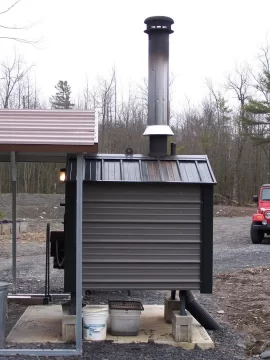

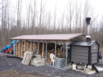

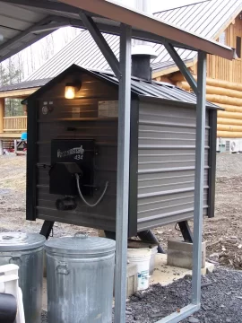

I had my 434 for 7 years, never any problems.. One thing I did for the door seal... Instead of the 1 inch rope,,, I used 3/4's.. First took the door off, laying on a 33 gallon metal trash can I used for my ashes..I put a piece of plywood down over the trash can for a flat working area. This was so you can leave the power cable hooked to the fan motor working right next to the boiler.. Pull out the old gasket when it got hard ,,, wire wheeled the groove with a cordless drill.. Brake Clean the groove. Next put a few spots of high temp RTV around the door gasket groove.. Next start the gasket, don't stretch it out, keep it kind of bunched going around,, I started in the middle of the hinge side. Once the gasket is all around, it should sit about a 1/4 to 3/8ths low in the door channel .. Next use high temp RTV that's in a caulk gun style tube and just go around and fill the whole groove on top of the gasket.. After you do that take a putty knife and smooth it even with the top edge of the door.. Let it dry for 24 hours, bolt the door back on and you now have a nice non hardening silicone gasket .. I will tell you it might make the door hard to get shut, but it will keep compressing as you let the door sit closed. You'll have a nice flexible seal that will not get hard , don't worry if you see the silicone tearing away from the edges of the door channel, it's still now part of the rope gasket.. That sealed great for years.. I dealt with "Boiler Solutions" for testing my boiler water an chemicals... They are great people... They even sent me a free water test kit and then sent me back a free report of the condition of my boiler water and any chemical I needed...

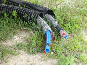

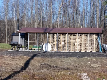

You can see I added a chimney and a simple storm collar .. That storm collar kept the water from getting down along side the pipe as it went into the stove... Problem, the silicone seal would tear away from the metal roofing and pipe on the stove top,, allowing rain to go down and soak the insulation...now your losing heat.. Storm collar was cheap for the pipe, just ran a bead a silicone where it met the pipe, put a bead on the area it will seal before the collar goes on and then a bead on the collar after it's on.. This was my set up for my wood and stove... Never had to stand out in the weather.. That shed held about 10 cords... Give ya some ideas! By the way you can see the good pipe laying on the foundation blocks, what was left... Then I slid corrugated pipe over that for UV protection where it came out of the ground..Think that Logstor pipe was like 15 dollars a foot..

thanks all..so ive gt the pipe al in the ground..just waiting on hvac guy...
ive got this years i think..if not ill be burning anything i can get my hands on ...lol
house is all hooked up..now i just gotta rig up something for the barn ..ill post pics soon
Heat exchanger all hooked up
