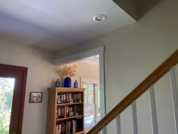

What is the ceiling like, all one level up to the stairwell? If so, creating a false transom to block the flow along the ceiling can help reduce heat migration upstairs. I did this in our house with good success. The ceiling was flat before I added this and the wood stove heat would head right up the stairs. With this block, it has more resident time in the living and dining rooms.
